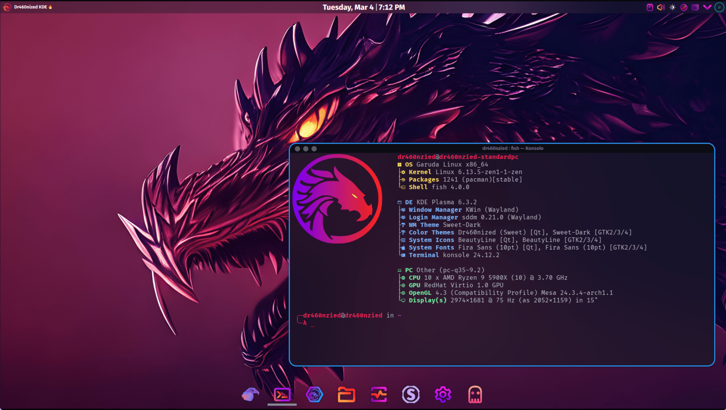

We tried to minimize impacts on theming. Here’s what the Dr460nized Theme looks like in Plasma 6 (1920x1080 resolution). Pretty much the same as before
The result may vary depending on the monitor resolution you are running at. For example, the bigger your resolution, the smaller the Digital Clock’s fonts will be and the bigger the bottom Dock will be. Of course, both are easily adjustable, there is no need to freak out if you see that.

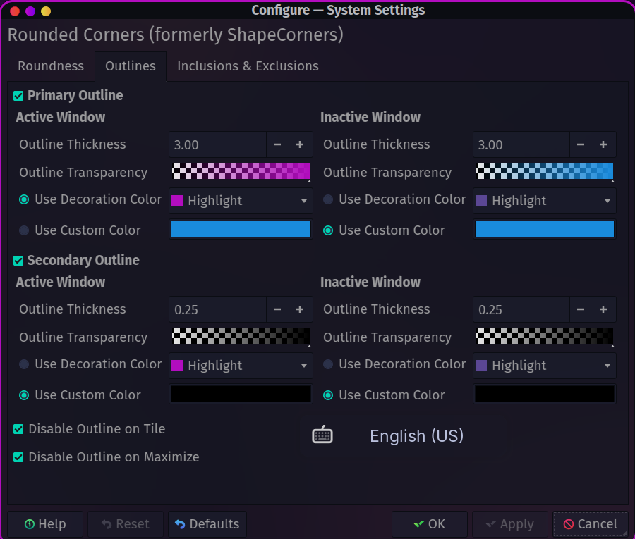

Later in the Plasma 6 era we added some UI changes.
kwin-effect-rounded-corners-git package. Then you open System Settings, Window Management, Desktop Effects and find Rounded-Corners. Replicate the below:
